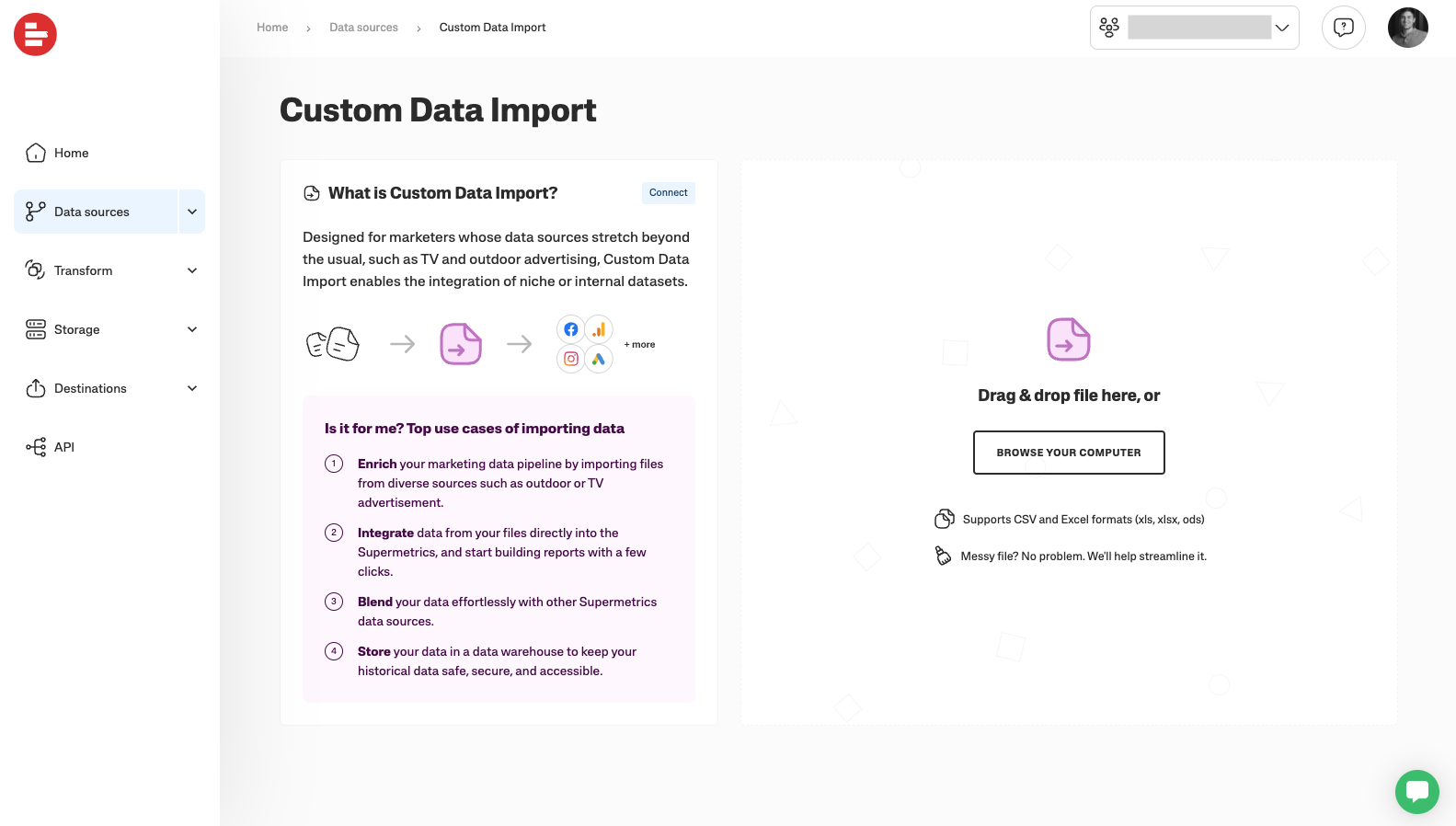

Step 1: Upload a file
  1. On the Supermetrics Hub, go to Custom data import under Connect.
  2. Click Browse your computer and select a file you want to upload.
    If you have existing imports, click New import and then Browse your computer to select a file.
  3. Data from your file will be read and you’ll be taken to the next step of the configuration.

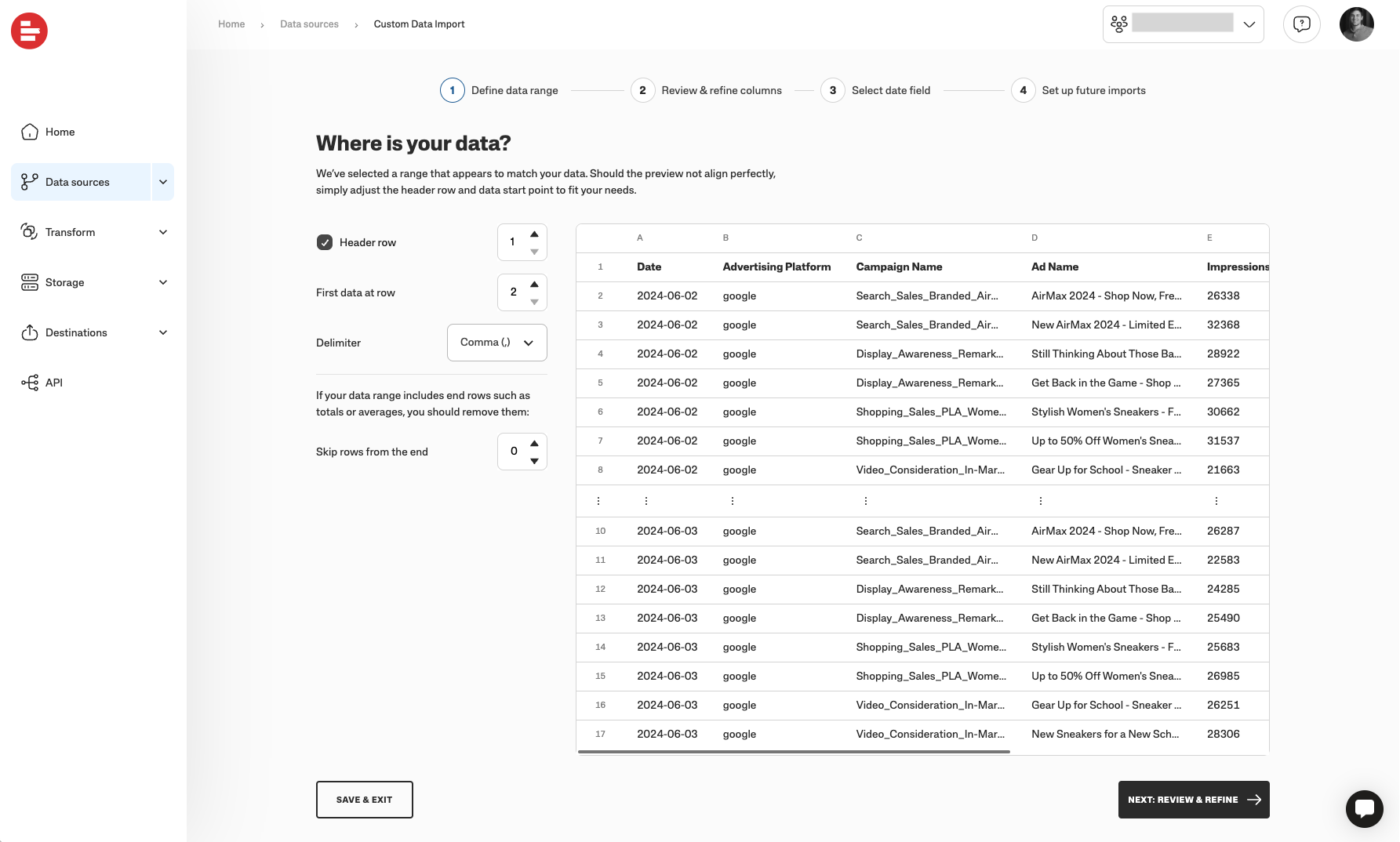

Step 2: Define which part of the file is read
In this step, you can define from which sheet and table of your file the data should be read, which row should be considered as a header row and if some rows of data should be skipped.
Note that the settings are different for CSV and XLS/XLSX files.
For CSV files:
  1. Adjust Header row is at to match the row where your column labels are.
    If there are no header rows, you uncheck the Header row check box.
  2. Adjust First data at row to match the row in which you have the first actual data values.
  3. If your file or table has one or more additional rows at the end of the file (for example, a total row that should be excluded from import), define Skip rows from the end to match the number of rows that should be skipped.
  4. Once your data looks correct, click Next: Review & refine to proceed to the next step.
    • Tip: Custom data import supports the following CSV delimiters: comma (,), tab, pipe (|), and semicolon (;). We detect the delimiter automatically from your file.
Data import interface showing data range selection and preview of data columns.

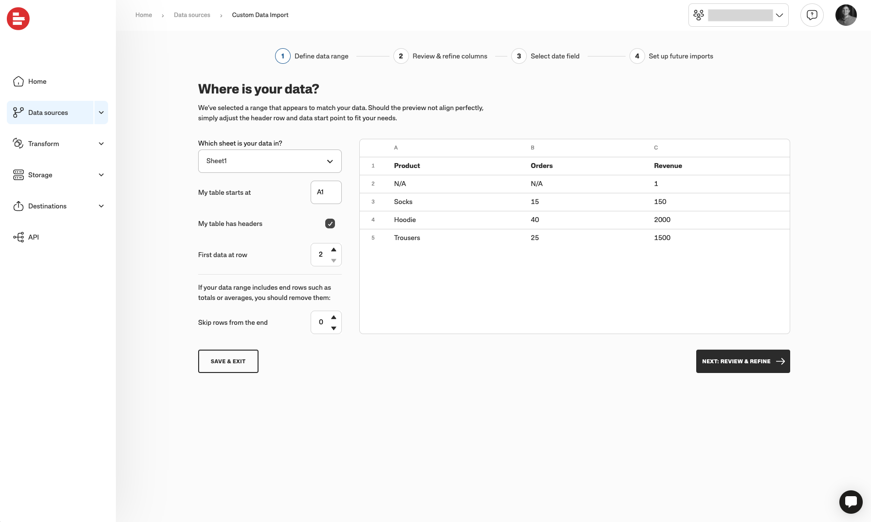

For XLS/XLSX files:
  1. Select the sheet from which you want the data to be read.
  2. Adjust My table starts at to match the cell value on which your table starts at. If your table has headers, point to the leftmost cell of the header row.
  3. Uncheck My table has headers if your table doesn't have a row for headers.
  4. Adjust First data row to match the row in which you have the first actual data values.
  5. In case your file or table has one or more additional rows at the end of the file (for example, a total row that should be excluded from import), define Skip rows from the end to match the number of rows that should be skipped.
  6. Once your data looks correct, click Next: Review & refine to proceed to the next step.
Data import interface showing product orders and revenue details in a table format.

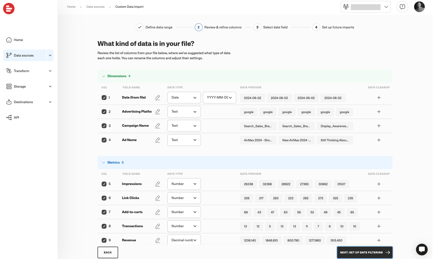

Step 3: Configure fields
In this step, you can adjust how data from each column of your dataset is handled.
Note
We try to recognize the data type for the fields automatically, but we advise you to review each field to ensure they've been detected correctly. Pay attention to dates and metrics to ensure correct behavior of import.
Overview of data import settings with dimensions and metrics for analysis.
Review the fields we detected from your file and adjust settings to ensure each column is treated correctly.
  • Column checkbox: Defines if the data is imported. Uncheck this if you want to the data be excluded from imports.
  • Field name: Name for the field shown when configuring a query in Supermetrics products. You can edit the name by clicking the pen icon.
  • Data type: With data type, you can define the format the data should be imported. Data type also defines if a field is treated as a metric or as a dimension. For date fields, you can also define in which format the date data is in the file. This allows you to ensure that dates and months are converted correctly to the unified format used across Supermetrics products.
  • Data preview: Shows you how the data from your file looks when queried in Supermetrics products. Use the preview to confirm that values from your file are treated correctly.
  • Data cleanup: Additional settings to clean up and transform your data.
    • Tip: You can use Find and replace to clean up unnecessary characters from your data, allowing you to match data with the desired data type.

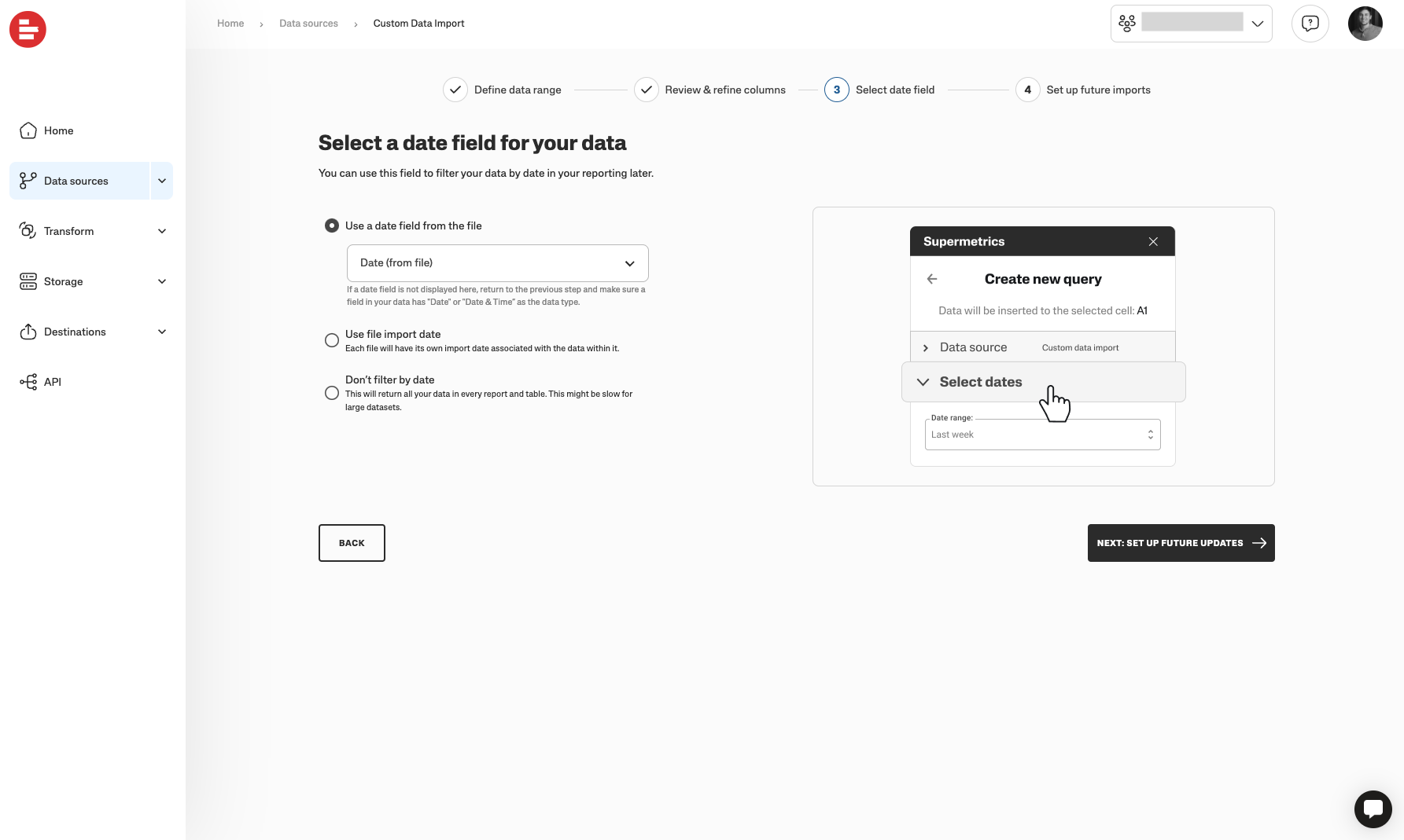

Step 4: Define date filtering
In this step, you define the date field to use for your data. The options are:
  • Use a date field from a file
  • Use file import date
  • Don't filter by date
Select the option that matches your data, and click Next: Set up future updates to continue.

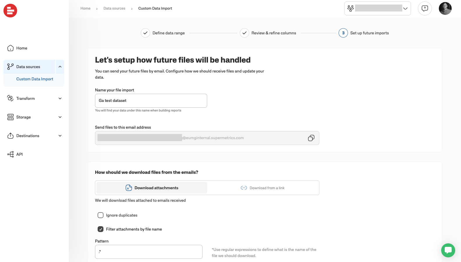

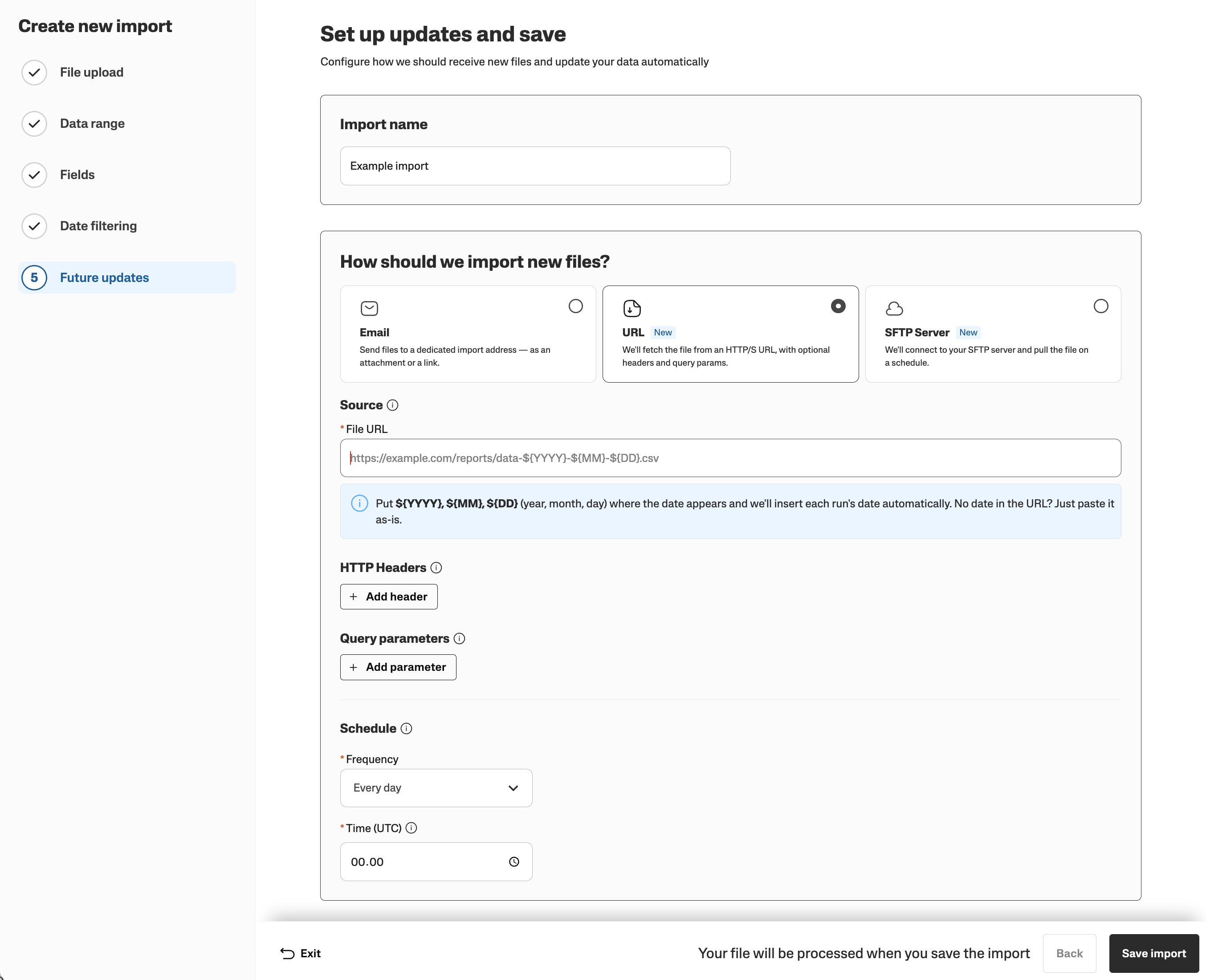

Step 5: Set up future imports
In this step, you'll define how the data is delivered and how the data is updated with each upload.
Instructions for setting up automatic file imports with various source options.
  1. Give a name for your import. You'll later find the import with this name when building reports.
  2. Choose the way how should we import new files:
    1. Incoming email attachments.
      If an incoming email can contain multiple files, you can define a file name pattern that we use to download only certain files from the email.
    2. Fetching from email links from incoming emails.
      Most of the emails contain many URLs. Please, provide a pattern that we use to reliably identify the right link to the data.
    3. Schedule fetching from an URL.
      Provide an URL, add headers and other parameters if needed for authorizing request.
    4. Schedule fetching from SFTP server.
      Configure host, port and remote path. Provide credentials: username and password or ssh key with optional passphrase.
  3. Define how data is updated when new data is uploaded. Learn more about different update types and their behavior.
    • Select Append if you want to ensure that already imported data won’t be touched and new data will be added to the end of the existing dataset. Please note that this can lead to duplicate data if files contain overlapping rows.
    • Select Full refresh if you want already imported data to be completely replaced with new data every time new data is imported.
    • Select Append & deduplicate if historical data can update (ie. due to the attribution window) and you want values for rows to be updated. Select fields which we use to detect rows to update when new data is imported.
  4. Click Save import to finish your import configuration.
