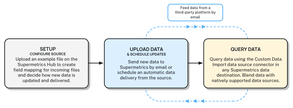

Getting data imported into Supermetrics and starting to use the data takes three easy steps:
  1. Configure the source: Upload an example file on the Supermetrics Hub to create mapping for fields, how data is updated, and how new data is delivered.
  2. Upload data: Upload new data through the Custom data import page on the Supermetrics Hub or send new data through email. You can also schedule an automatic data delivery directly from the source.
  3. Query data: Query data using the Custom data import connector in Supermetrics data destinations or blend data with other data sources.
Flowchart illustrating data setup, upload, and query processes in Supermetrics Custom data import.

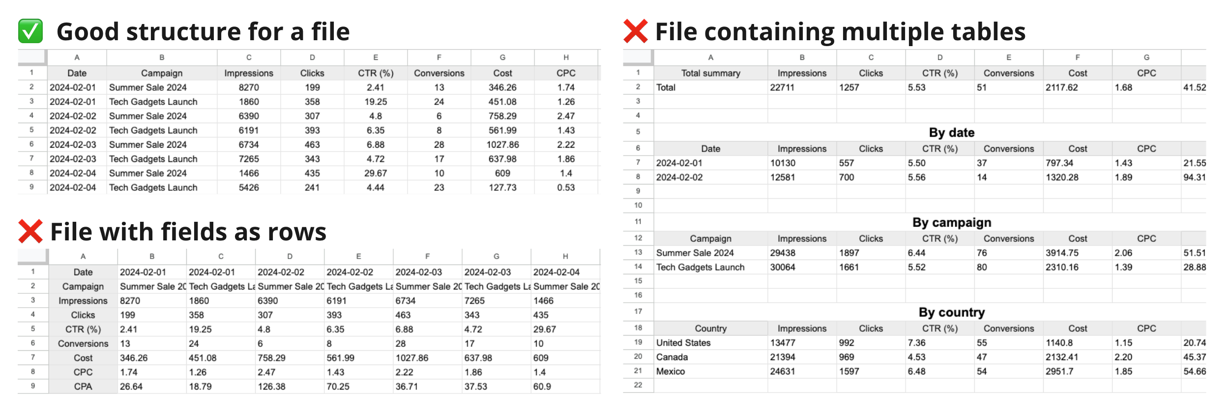

File structure
While the import can be configured to handle different kinds of file structures, it's good to follow these guidelines for file structure if possible:
  • A single table of data per sheet
  • It's advised (but not mandatory) to have a header row with column names to ensure correct organization of data
  • Fields should be ordered horizontally, and data needs to be listed as rows
  • The order of the columns must be set and must not change
  • It's advised to have some form of a date available as a column in the file. A date column allows you to query imported data for specific dates. Date can be, for example, reporting date, created date, purchase date, or conversion date. However, having a date is not mandatory.
See below for examples.
Comparison of well-structured and poorly structured data files with highlighted examples.
