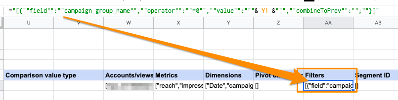

    Here’s a formula for replacing the CONTAINS filter string for Facebook Ads Campaign Name with a cell reference for data in Y1 of the same sheet.
    ="[{""field"":""campaign_group_name"",""operator"":""=@"",""value"":"""& Y1 &""",""combineToPrev"":"";""}]"
  6. Place the new formula into the cell directly for the filter, or you can use another cell reference to the formula (this is useful in case it gets overwritten). Spreadsheet showing campaign filters and metrics with highlighted filter section.
  7. Load the query in the sidebar and click Refresh (but don’t modify, as this will strip out the formula).
  8. The query should now use the cell reference to drive what is filtered.
