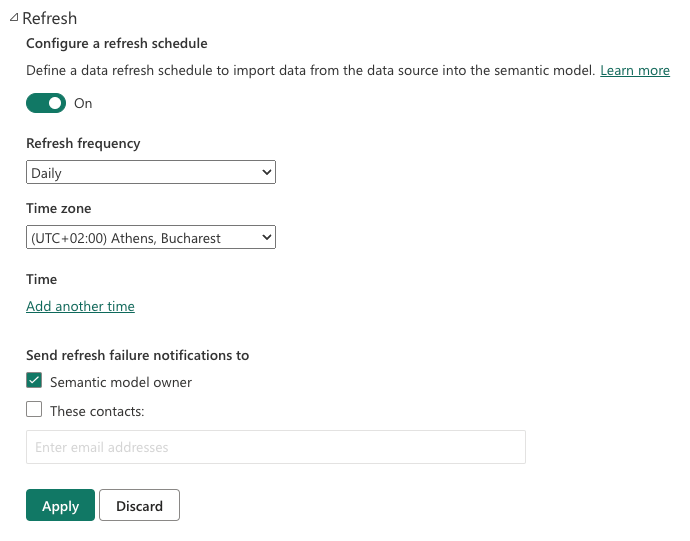

Open the Refresh tab.
Turn the toggle on and define the refresh schedule you need.
Click Apply.
