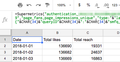

The Function option inserts the function into the sheet along with the results. If you click the upper-left cell of the results in the table, you see the function.
Spreadsheet showing dates, total likes, and total reach metrics for social media data.

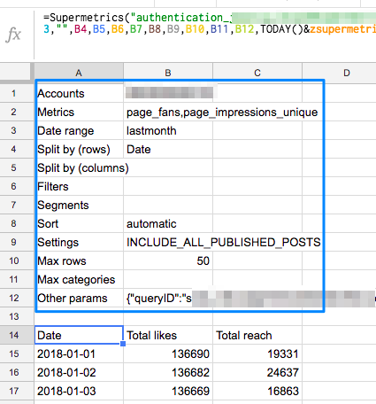

The Function (+params) option inserts the updatable parameters into the sheet, and the function is available in the top-left cell of the results table.
Spreadsheet displaying social media metrics, including likes and reach over specific dates.
